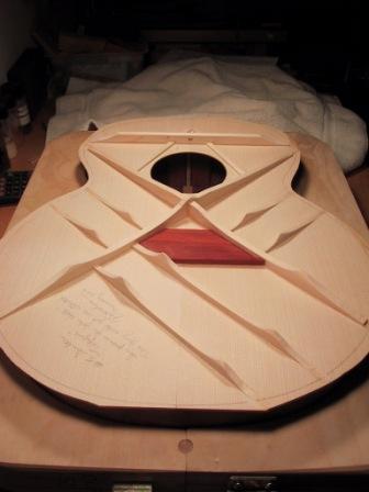

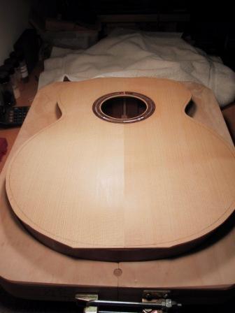

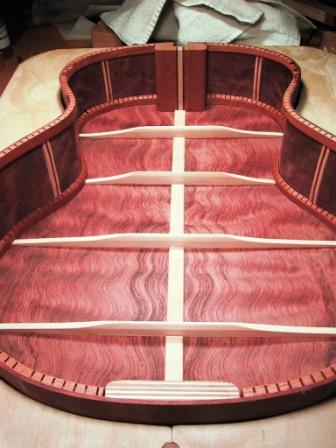

So I thought I'd post a few pics of the boat and top to elicit any constructive comments before sealing it up in a week or so when conditions permit.
The guitar follows Michal P.'s plans with some slight modifications. I'm using Zootman's WFB and Carpathian Spruce. All bracing is Adirondack spruce and all glue joints are HHG. Check out the pics and let me know what you think:

JJ that is looking great. Nice neat clean work. I'm sure it's just a shadow but the bridge plate looks a bit thick? Cool side braces too. Bobc38767.4648726852

Wow, that does look great. I was actually a little curious about that
bridge plate also.
How tall are the peaks on those x-braces? I've never looked at these
plans before, but that is some beautiful shaping.
PostPosted: Sun Feb 19, 2006 4:11 am
Bridge Plate...The Padouk plate is .090" thick but it has a 3/16" brace at the south end. I got that idea from John K. and Mario. The bridge plate is glued tightly to the adjoining bracing but not let into the braces...one departure from the plan.
X-Braces...The peaks are about .750" per Michael's plans.
Side braces...These are the cut off scrap laminate wood strips from the laminated neck blanks I build. Just wouldn't think of scrapping them!

Looks very nice....but....
It almost looks like your sides aren't running parallel to each other at the waist? If so, you're going to have a different sized top than back...perhaps it's just my imagination.
Other than that and the bridge plate others mentioned it looks great.
What does the inscription say?
PostPosted: Sun Feb 19, 2006 5:12 am
Don...you just scared the hell out of me so I ran downstairs and checked the waist dimensions. You're right...there is a 1/16" difference between top and back at the waist. Good eye for a "former" luthier! Actually they're both square and parallel. I believe there is some parallax distortion due to the angle and lens combination that makes it look out of kilter.
Inscription...As you may know, I name all of my guitars. I don't want to reveal the name of this one until it's completed. The inscription is just something personal I write based on the person for whom it is dedicated. In the past, I named my guitars for my sons and brothers for whom they were made. This one is for me so I named it in honor of someone who provided inspiration in my learning process.

[QUOTE=Don Williams] Looks very nice....but....
It almost looks like your sides aren't running parallel to each other at the waist?[/QUOTE]
Me thinks it is the camera distortng that view.
LOVE the wood!

Very nice work. I love the three piece side braces and laminated head block. Very classy!

Very nice work JJ. I too like the use of the laminated side braces and neck block. It really adds to the guitar.
PostPosted: Mon Feb 20, 2006 3:10 am
Very nice JJ, looking good. Your workmanship is tight and clean and I like those laminiated braces. I think is better to glue at 35% than 65% but I would wait till you were in the 40's if possible. Looking good JJ, keep it up.

JJ--I just saw my set of that WF Bubinga this a.m., and thought of you and your project. So nice to see it...thanks for posting. (Only now I'm going to have to get off my duff and get mine built.)
My comment would be on those bracing peaks--.750" seems excessive. The Martin Herringbone plan has the tallest dimension for the "X" at 5/8"--what's that, .625"? And the second peak, closest to the edge is c. .500"
Since your top is still off, you can at least tinker with those peaks some, if you choose to do so.
Looking really clean!
PostPosted: Tue Feb 21, 2006 2:26 am
Thanks, Steve. I'll take a look at those peaks when I get home this weekend. One of the reasons it takes me so long to build is the time it takes for me just to re-familiarize myself with the project after weeks of absence. Your suggestion certainly is timely since it can be more easily modified now.
As for getting off your duff and getting the WFB sister in the game, I'll be most interested in learning how an "adult luthier" approaches the build. Any ideas as to what you'll build with it yet?
